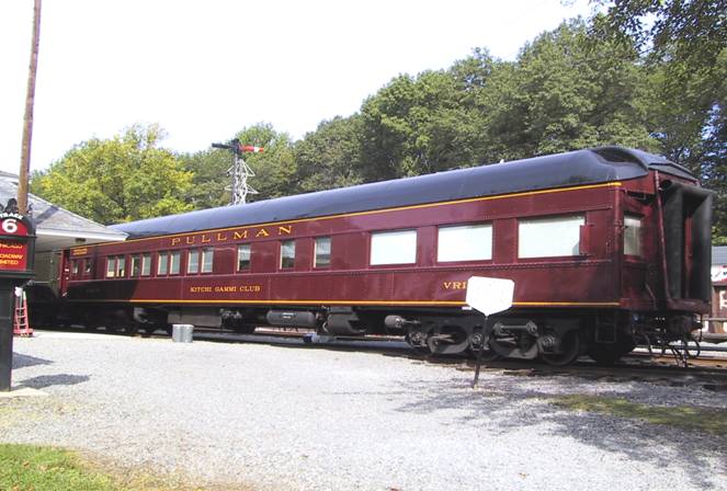

Postby MurphOnMillerAve » Fri Jun 08, 2018 1:57 am
Roy wrote:Guys, this is a very worthwhile thread you've started here. However, it doesn't belong here. Do you think Bill would be averse to adding a structures and scenery subforum?
Lots of things - subjects - get discussed in a Club Car. The topics range as far as the gentlemen desire conversation to go. This subject belongs here because we have brought the subject up here for discussion. Those interested will gather around our spot and contribute something interesting, with goodwill and friendly intention. We seem to be enjoying this. Can't you let us have this bit of fun, here, where we frequent each other's company so often, Roy? :D Please.
