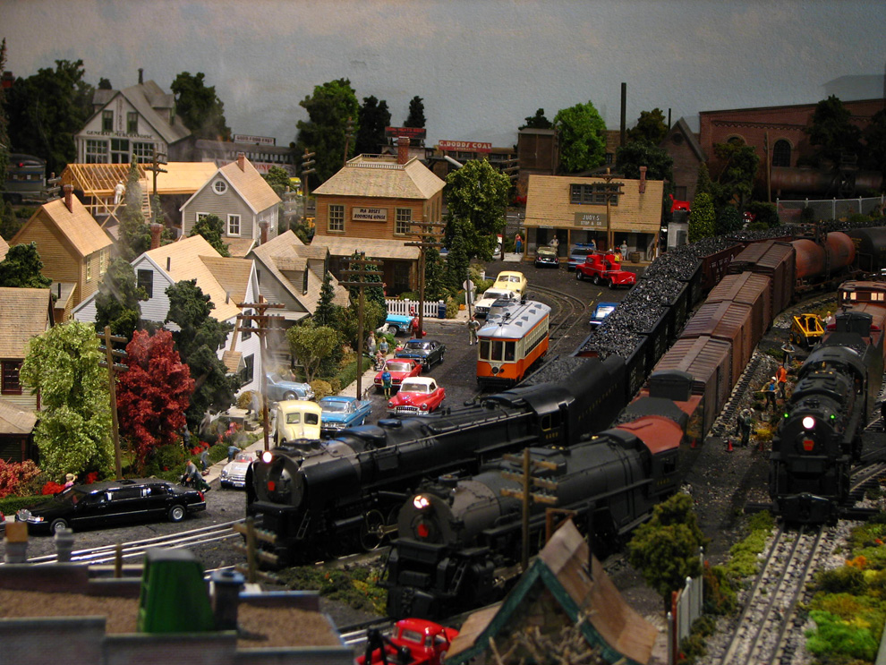

Rule1: Don't get cute. Or precious. That is, don't treat any scene, finished or on-its-way, as already so adorable it freezes-up your creativity and need to explore and express further options. Also, at times, it's wise to walk away, for some moments or for a day or two, to get a further perspective on what your hands have created up to that point. I have ripped apart more than a few scenes that I thought were lies.
For example, here is a between-the-tracks hot-mess, which I am ashamed to even show here, that I thought was adequate at the time (2006) but subsequently came to regard as a hot-mess, so it got ripped out. To me, ground-cover and lone tree came to look like a pile (of products) not like anything even approaching realistic.
- hot-mess

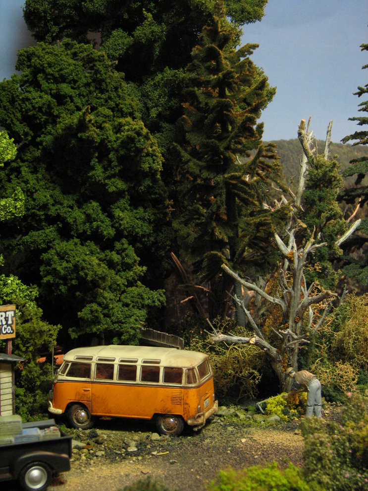

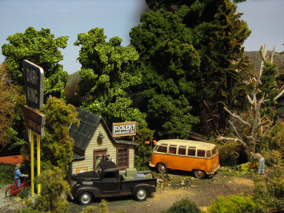

Murph – Thanks for that. Having seen many pictures of your layout over the years, it’s been obvious to me that the “art” of scenery is far more important than the technical assembly. That is borne out in your text. One can craft a great looking tree, but if you jam it in the wrong place it looks and works poorly.
As a pre-war tinplater I have lived in a world of luffa, wire, pipe-cleaners, lichen and pot-scrubbers. What fascinates me most about your scenes is the quality of the foliage and the realistic trunks/branches (putting aside the fantastic buildings). When you can see individual leaves on the trees, that’s impressive.
I’ll check out the suppliers you suggested. The materials would certainly be an upgrade over what I’ve toyed with in the past.
In Peter Riddle’s standard gauge book he advocated scenic’ing a tinplate layout similar to your methods…incrementally, in small sections, each on a Masonite base which can be developed off the layout, then incorporated on completion. This is similar to some of the pre-war “plot” methods Lionel developed and marketed during the 1930’s, only theirs being far more primitive in execution. I’m going to take a whack at this once the shoulder heals up.
Again, thanks for the pointers.
P.S. You're killing me with that VW bus...got to find one of those.

healey36 wrote:Murph – Thanks for that. Having seen many pictures of your layout over the years, it’s been obvious to me that the “art” of scenery is far more important than the technical assembly...
...I’ll check out the suppliers you suggested. The materials would certainly be an upgrade over what I’ve toyed with in the past...

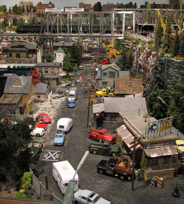

The kit was purchased from Valley Model Trains, I believe, at least ten years ago, and I named the building just to get something on the layout, in those early days of Moon Township, that memorialized names from my youth in Duquesne and Mckeesport, Pa. The Monongahela R. passed between those two towns, and bridges were built to share lives of the people and to attend to needs by the mills (Duquesne Works; National Tube) to share product, like the so-called bottle cars that carried extremely hot liquid metal and were so heavy (lined with bricks to protect the outside world from their sun-like heat) a special span was built to cross the Monongahela to bear trains of prodigious weight.
Also, as a child, my mother nearly drowned in the river while swimming with her brothers along the shore, where there was a low shelf that reached out underwater into the main stream of the river for a particular distance; somehow, she had drifted too near where the edge of the safe area dropped quickly into the depths and the main channel, dredged to accommodate the barges carrying such materials as coke and iron ore, quietly but effectively muscled its huge way by. Her brother, Charles, immediately realized she had been grabbed by the deep water and reached out and grabbed her by the hair just in the nick-of-time. It always fascinated me, once I had been told that story, what a difference that day would have made in my life if he had not reached her.
So, that's my Monongahela story of how that building (modeled in a Pennsylvania red brick tone, modeling the brick of our house) came to be named.
P.S. The Monongahela bldg. was not situated in its present location at first. Here is its original site.

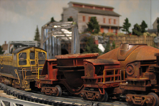

- heavily weathered steel industry "bottle-car"
- IMG_5750.jpg (541.11 KiB) Viewed 2203 times
- bottle car in background track right next to ladle car
- 18.jpg (245.81 KiB) Viewed 2202 times
- 11a.jpg (141.54 KiB) Viewed 2199 times

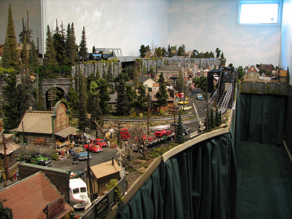

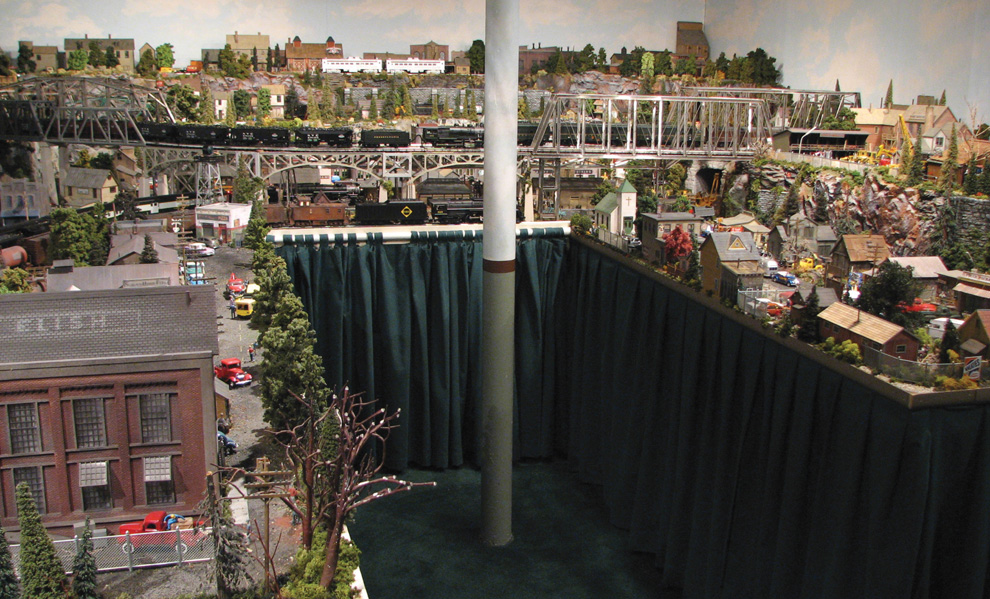

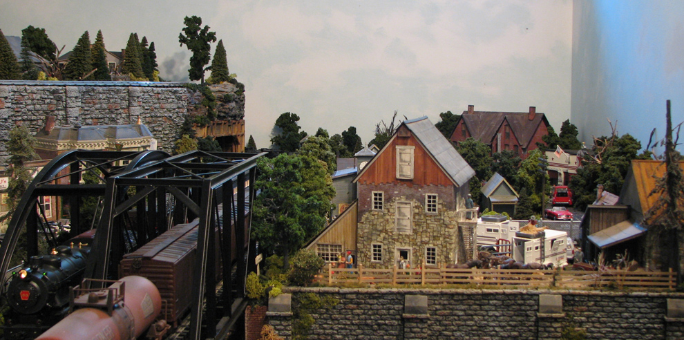

Not possible. Would that it were. The train-room meanders from one "room" to the next, taking a sharp-right at approx. 2/3 the way from the cellar entrance stairs to the last wall, in the new section, which was carved from the garage and added to the basement to accommodate an expanded layout.

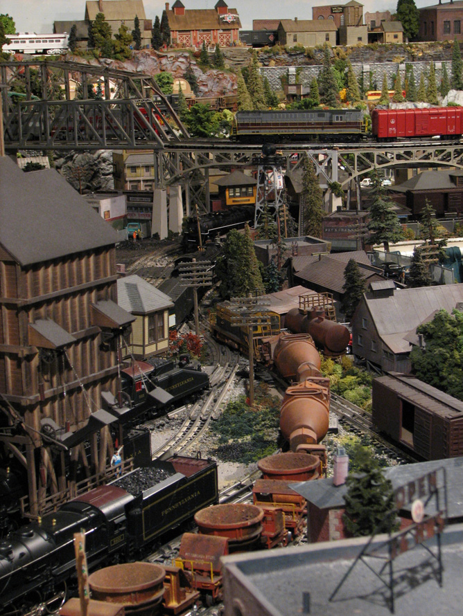

The best I can offer is the following array, which walks you from the a portion of the first neighborhood viewable at the foot of the cellar stairs, along the "neck", to the rear mid-section and its valley, and then looks to the right into the newer section...
Fun?
- a view of approx. 1/3 the front, first section at foot of stairs
- ww78.jpg (392.25 KiB) Viewed 2172 times
- ...looking from more of the "neck" toward the rear valley/mid-section
- IMG_5521.jpg (368.99 KiB) Viewed 2170 times
- "the neck" of the layout, connecting first main section with the middle...
- IMG_8267.jpg (410.05 KiB) Viewed 2169 times
- the intersection of the original layout, rear mid-section, and the newer extension that leads off to the right of this spot...
- IMG_0494.jpg (533.26 KiB) Viewed 2170 times
- the valley in the midsection...
- e.jpg (586.15 KiB) Viewed 2170 times
- a look back at the part forward of mid-section
- b.jpg (568.38 KiB) Viewed 2169 times
- mid-section with rear valley beyond column; extension is to the right...
- 2.jpg (343.31 KiB) Viewed 2169 times
- newer section, off to the right on the main, original layout
- IMG_1063.jpg (566.3 KiB) Viewed 2169 times
