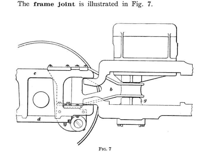

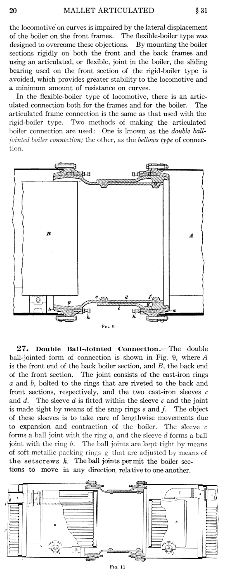

That is a long locomotive. How is it going to negotiate curves?
A hinged frame and ball joint in the boiler you say? Yeah, that ought to work!
Re: Yeah, that ought to work!
Posted: Fri Apr 08, 2016 11:07 pm
by MurphOnMillerAve
Yes, but would not that big driver wheel right at the joint prevent any flexing there?
Posted: Fri Apr 08, 2016 11:52 pm
by webenda
MurphOnMillerAve wrote:Yes, but would not that big driver wheel right at the joint prevent any flexing there?
There are two ball joints, one inside each boiler half. I can see the frame pivot through the spokes of the wheel. With a double ball joint joining the boilers exact alignment of the frame pivot with boiler joints is not necessary. Figure 7 shows a similar frame pivot with the yaw pivot point behind the wheel.
