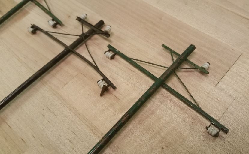

I am reluctant to thread drift here, as Jon and Pete's conversation is of interest. But, to answer Carey's question, I have never heard of or, as far as I know, seen anything by Druck. However, these came in just this week, donated by a good friend in support of the club's traction layout efforts:
All steel. We plan to use them.

R.K. Maroon wrote:However, these came in just this week, donated by a good friend in support of the club's traction layout efforts. All steel. We plan to use them.
Made by International Models, I have several loose ones and (somewhere) a box of them. The ones that I have are brass, not steel. Not shown in your photo is the rectangular base that the pole is soldered(?) into; it has two mounting holes, one near each end on the long axis.
