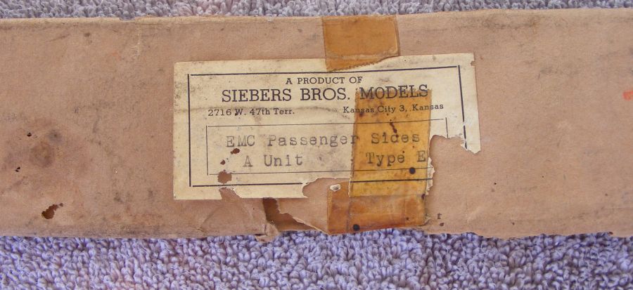

Thanks for posting all the photos. The sleeve for the Siebers Bros. sides is really cool and probably extremely rare (not to be confused with extremely valuable):
Siebers Bros. was one of several companies that sold locomotives made from Adams and Son castings but there is not much more than a trace of their name these days, as they didn't mark their models (and A&S marked their castings).
The short sides are for the E7, the long sides are for the EB, which I believe is the same for the E6 and E7. That is, there is no difference, at least cosmetically, between an E6B and an E7B. Somebody correct me if I am wrong.
The built-up EB looks like it has the Siebers Bros. chassis. Bob T. will take note of the rivet baton strips, a feature not often seen. Looks like pretty good work at a glance. While, as stated, I don't believe there is a difference between a prototype E6B and an E7B, there is a difference in the roofs of the Adams and Son casting set for their E6 and E7. This particular EB has the E7 roof (which is more accurate -- the roof for the A&S E6A and E6B is greatly flawed).
