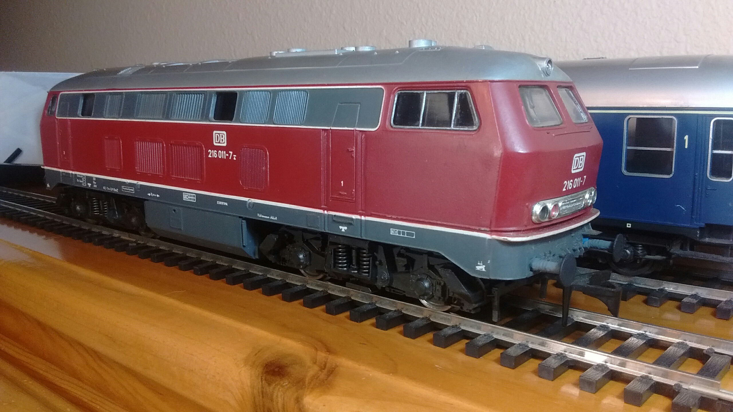

I've always had a thing for German stuff; the first issue of Model Railroader I ever bought (May 1969) had a short blurb in the "New Releases" column mentioning this loco. Something about it appealed to me, and was able to finally score this one (and 2 passenger cars) on eBay this past December. It didn't run, but I had a couple of motor/gear sets from a Fairbanks Morse model that turned out to be drop in replacements. It has the same self-contained powered trucks as the FM. (Think a very primitive version of NWSL's "SPUD".) It actually runs very well, and is surprisingly quiet. Since this photo was taken, I have upgraded the hand rails and tried to detail some around those HUGE couplers.

Excellent Mark; I’ll see your DB 216 and raise you a FS E444 “Taratuga.” I’ve always had a thing for Italian stuff (see “Basement full of Carcanos.”) When Roy Hill, late member of the DFWOSM, bailed on O scale back in the nineties after G scale exploded commercially he sold off all kinds of AHM he had in his stash for dirt cheap; I couldn’t resist this one; thinking I could kit bash it into a AEM-7 or some such which mercifully (for a change) didn’t happen before Atlas did theirs. It’s a good runner too, maybe it’s the turtle on the side of the far cab, but I can’t bear to tear this apart, it’s just too cool. Need to find it a home. My experience is the AHM drives have zero durability for pulling anything substantial in weight/rolling resistance, but can cook around nicely when trailing styrene car-bodies with delrin trucks. I have a train of the same specifically earmarked for them and other like “snow flake” factory drive equipped models.

That is one very cool loco; if you really "need to find it a home", all I can say is Oregon is a nice place...
FWIW, as I obtain a piece of Euro rolling stock now and then, I've been replacing the stock wheel sets with Weaver/Athearn items; they roll much nicer, and with the RP25 flanges look better, too! I'm finding the Lima wheels are often slightly "out of round", and are almost always tight in gauge. The Rivarossi, not so much.
