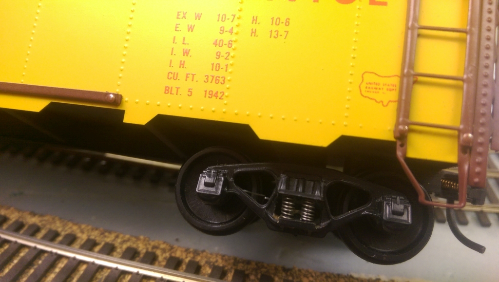

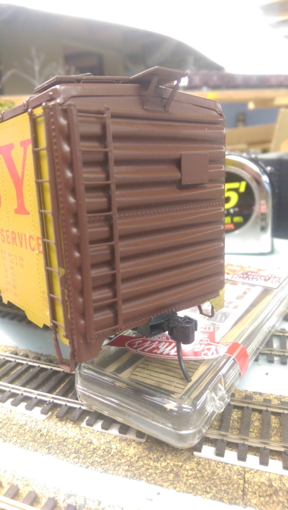

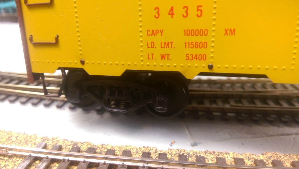

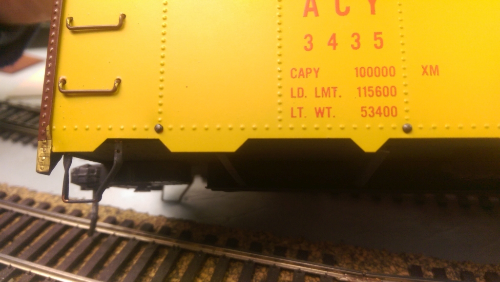

Here are some pictures of the car in question. The ends, roof and sides are metal. The floor and the substrate under the roof are wood. It's neat that they at least tried to disguise the pins by lining them up with a line of rivets, or attaching them through the ladders.
- Posts: 13676
Re: Manufacturer I.D.
Nice work. Those pins were huge. The ones that come in the kit are less obtrusive.
How did you get the paint to match so well?

How to tell whether a 40' steel sided boxcar (with metal roof, metal ends, and metal underframe) is an Athearn car or an All-Nation car:
1) If you measure the length of the car from the underside, from the inside of one metal end to the inside of the other metal end, an All-Nation car will measure 10", whereas an Athearn car will measure 10-1/8". This is the same dimension as the car sides.
2) If you open the doors, an Athearn car will have a wood or composition inner wall, whereas an All-Nation car will not.
3) Just below the right end of the lower door slide, the scalloped edge along the bottom of the car side, an All-Nation car will be cut vertically, whereas an Athearn car will be cut at an angle, just like all of the other scalloped edges on both cars. Obviously, a modeler could trim an All-Nation car to look like an Athearn, but an Athearn car would never be made to look like an All-Nation.
4) Along the bottom edge of the roof overhang, along the side of the car, most Athearn cars will have a row of rivets, whereas an All-Nation car will not. Do not confuse this row of rivets with the row of rivets along the top edge of the car side, which both cars have.
The ACY car looks like a mixed bag to me. The sides are All Nation. The frame and running board parts are Athearn. Possibly the roof as well as there is a significant over bend in the roof ends to make it match the short All Nation sides.

CMorrill wrote:The ACY car looks like a mixed bag to me. The sides are All Nation. The frame and running board parts are Athearn. Possibly the roof as well as there is a significant over bend in the roof ends to make it match the short All Nation sides.
Charlie
Good eye, Charlie -- I had not noticed the roof overhang.
And thanks to Rufus for the spotters guide information. I was aware of the scallop difference at the bottom of the sides but not the other details, like the rivets on the roof overhang. And I have yet to learn the difference between an All Nation and Athearn frame. Charlie apparently knows though.
- Posts: 42236
R.K. Maroon wrote:And I have yet to learn the difference between an All Nation and Athearn frame.
I think the AN one has all of the struts doubled back to back with the truck mounting screw between a pair of them at each end.
