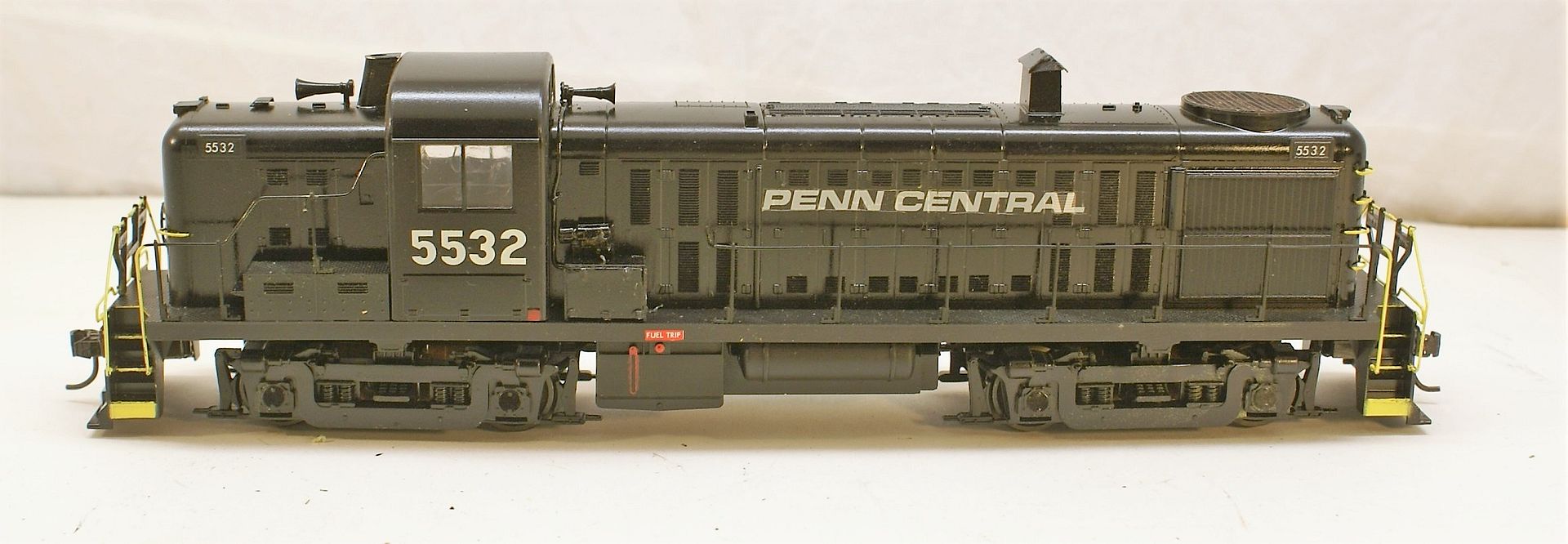

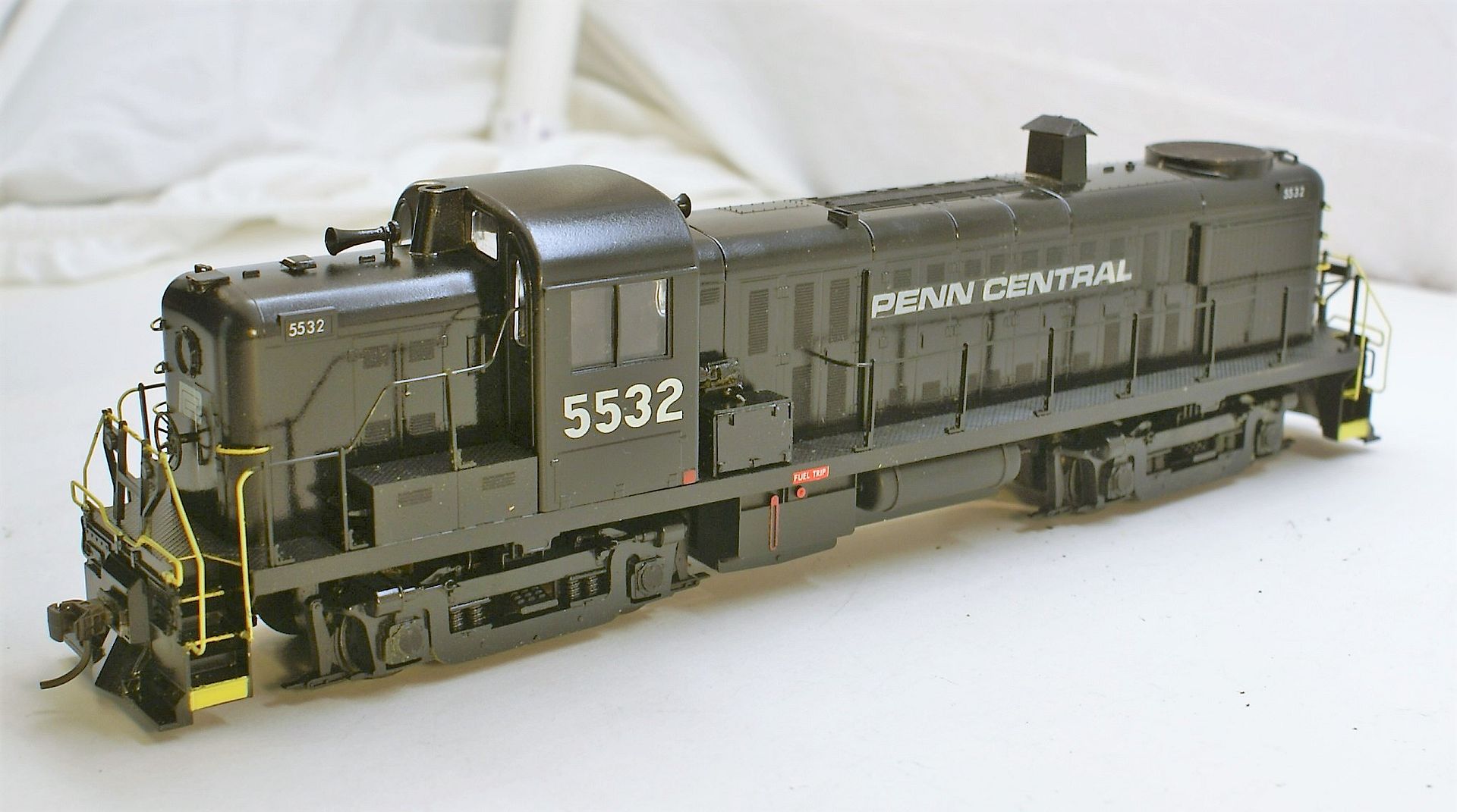

Trying to keep up with Sarge these days, adding to my older US made Weaver stable;
I got this RS-3 pretty much in pieces due to it getting mailed solely in the factory box. The motor and weights tore loose inside the carbody and pretty much blasted the u-joint clevises apart along with part of the stanchions.
#5532 was originally ex-NH #522, repainted at Collinwood shops in 1970 to this incomplete scheme.
After repairing the drive train, I removed the factory scheme and added some P&D grabs, fan kit, an Alco factory style sg stack typical of the NYNH&H and the PRR’s dual purpose RS-3’s.
The ATS box was scratched from styrene and parts off an NYC ATS set, and the “peaked” NYC style spark deflector scratched from brass sheet.
Opinion, but few external car body options change the profile look of a locomotive quite like the Alco factory styled SG stack on these early Alco’s, which look a tad clunky in the freight only config or with the separate up-right pipe exhaust as found on NYC, C&NW and D&H units.
Paint is Ace Gloss Black via rattle-can and Testor’s Daytona Yellow, decals a mixture of salvaged Champ and Walthers sets. There’s something therapeutic for me in gussying up these factory models with add-on parts and it’s rare I do any locomotive project without something from either P&D or Des Plaines or both.
I got this RS-3 pretty much in pieces due to it getting mailed solely in the factory box. The motor and weights tore loose inside the carbody and pretty much blasted the u-joint clevises apart along with part of the stanchions. #5532 was originally ex-NH #522, repainted at Collinwood shops in 1970 to this incomplete scheme.

Very nice. I remember similar units on PRR and PC many years ago.
Re: Paint Shop
Thanks Roger, Pennsy did indeed have a fleet of these dual-purpose versions with this integrated SG stack, I believed they bought them to dieselize the commuter runs out of Pittsburgh. A lot of them made it to the PC era, the detail differences between them and the New Haven's include an extra battery box which extends the cab walkway out an extra four feet from the cab door on the right side of the long hood. They also had large bridge plates on the end platforms, a feature I didn't want to do either. and vertical twin sealed beam headlights, I believe they originally sported an elaborate train-phone antenna array too. Maybe next RS3

De Bruin wrote:TI got this RS-3 pretty much in pieces due to it getting mailed solely in the factory box.
I'm surprised that the frame didn't break. That's usually what happens to poorly packaged Weaver RS3s -- the plastic frame can't withstand the bending moment when something impacts the pilot and steps
You did a very nice job -- maybe you need a Dewitt Geep to go with it?
