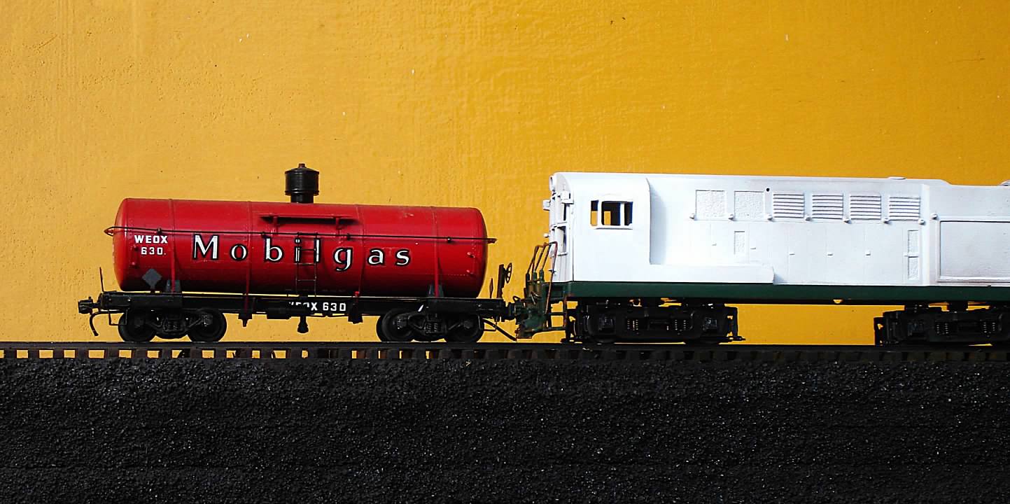

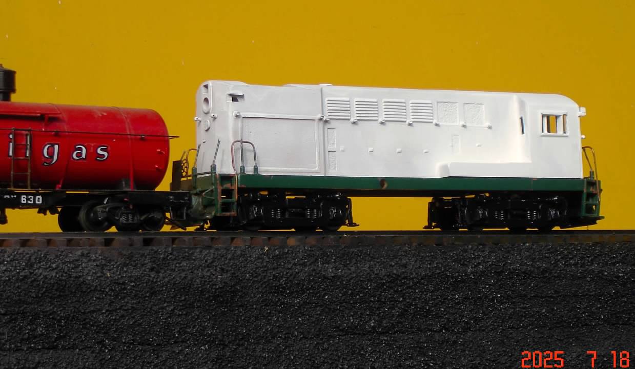

Jim sent the above castings the other day. I just sliced the front bulkhead out of the casting on both sides, folded two chunks of 1/16" thick brass to fit, and soldered the whole mess together. I am off to the bead-blaster, then final priming and finishing. Look for a photo in a day or so. We think it looks better already - I have turned down freebies on these things several times because of that cab, but like the CLW PA nose, castings can, with effort, be modified.
Posts: 13676
Re: Doorstop four axle Diesels
Postby bob turner » Fri Jul 18, 2025 9:11 pm
Done. Jim is going to add the grillework, straighten the hand rails, and power the thing. As of right now, it looks like it will be P&WV.
As above, I added metal on the sides and forward cab bulkhead, and in the window area - all 1/16 brass, held with lots of solder. Then to cover the slight blemishes, I used auto glazing putty - never more than about .010, which is less than a 64th.
I think it transforms a truly ugly model. There is a remote possibility that I would do one for me - SP Tiger Stripe. I gotta tell you, the castings would have to be free.

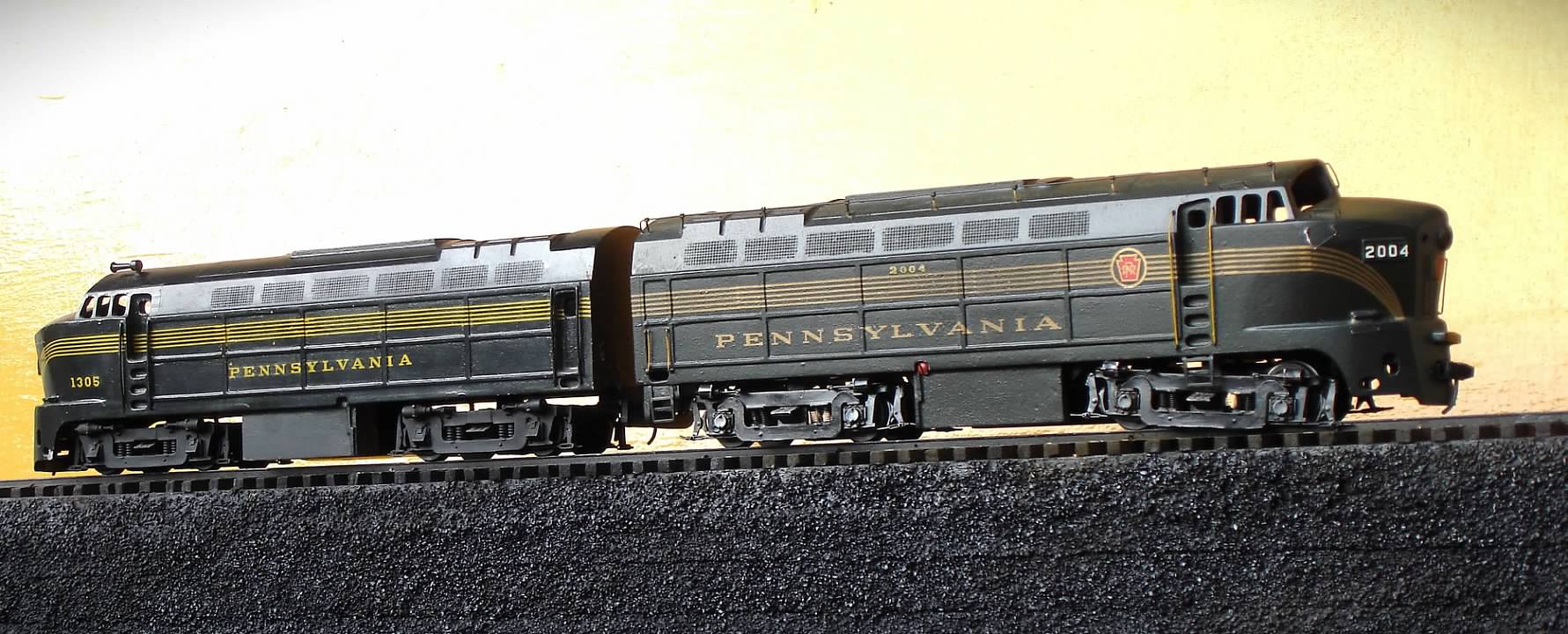

A pair of Sharks! Thanks, Jim.
This time all the wheels are on the track, but the journal slipped out of the sideframe on that front truck. Temporary repair was a pair of wires over the drop equalizer. Further research is necessary, since they are not held together with screws.
Note that the truck sideframes are larger on the lead unit - the rear unit has Kemtrons. I think the lead is CLW.

They look good together, Bob. Glad my lone single unit found and running buddy. I believe you are correct that unit 2004 has CLW trucks. Here are a couple of underside shots:

See those two prongs that jut "up" from the leaf spring casting? I scraped the paint off the very top and soldered on a very wide "C" channel, to hold the bottom of the side frames together. I have another pair like these, where someone soldered a crossmember between the two drop equalizer bars. Apparently, splaying is a common trait for these relatively nice looking trucks.
After bending those really heavy duty cotter pins and tightening the bolster attach nuts, the thing ran pretty good. Its next owner should disassemble all gearboxes and put some Teflon grease in there.
