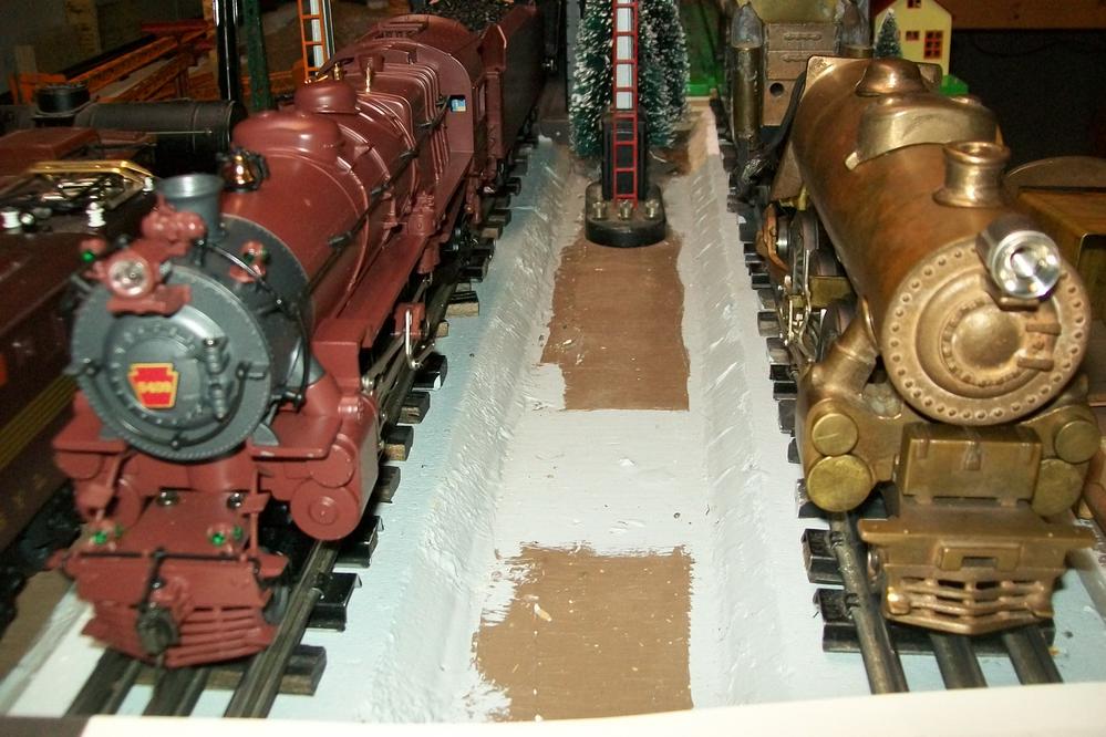

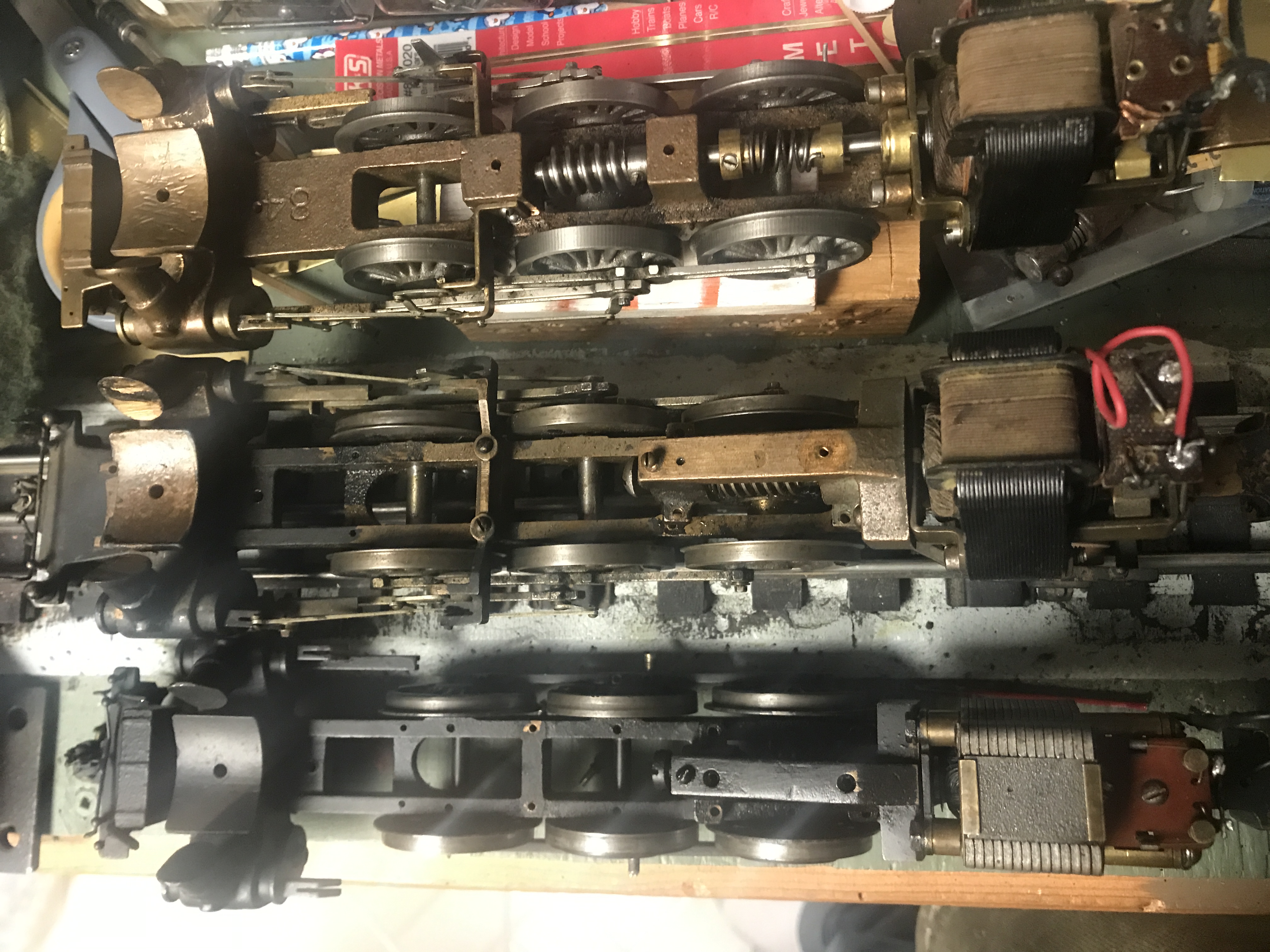

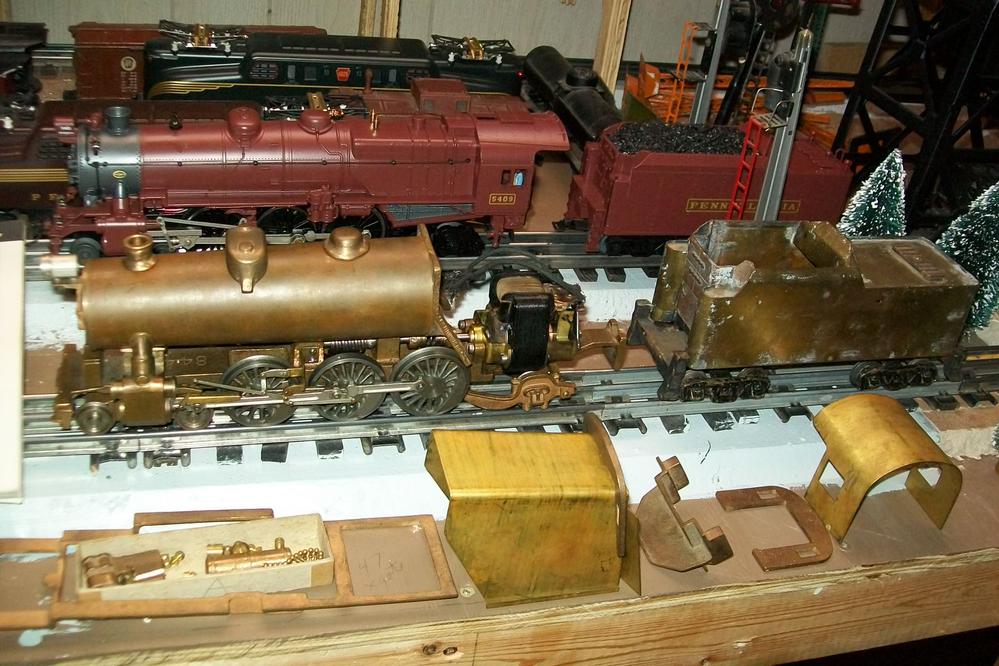

While I'm at it, here are the starting points for these. The first one I got was in pieces with the frame built up. I'm not sure if it was a factory built up frame or not. One thing I notice is that the motor mounting holes place the motor shaft considerably lower than the worm gear shaft centerline which puts the spring drive under a bit of a bind. The Toyota hose would probably help that but raising the motor up would as well. I'll get some hose and check that out though. It has the stock SC Cresent drivers like most of them and not 2 railed as far as I can tell.

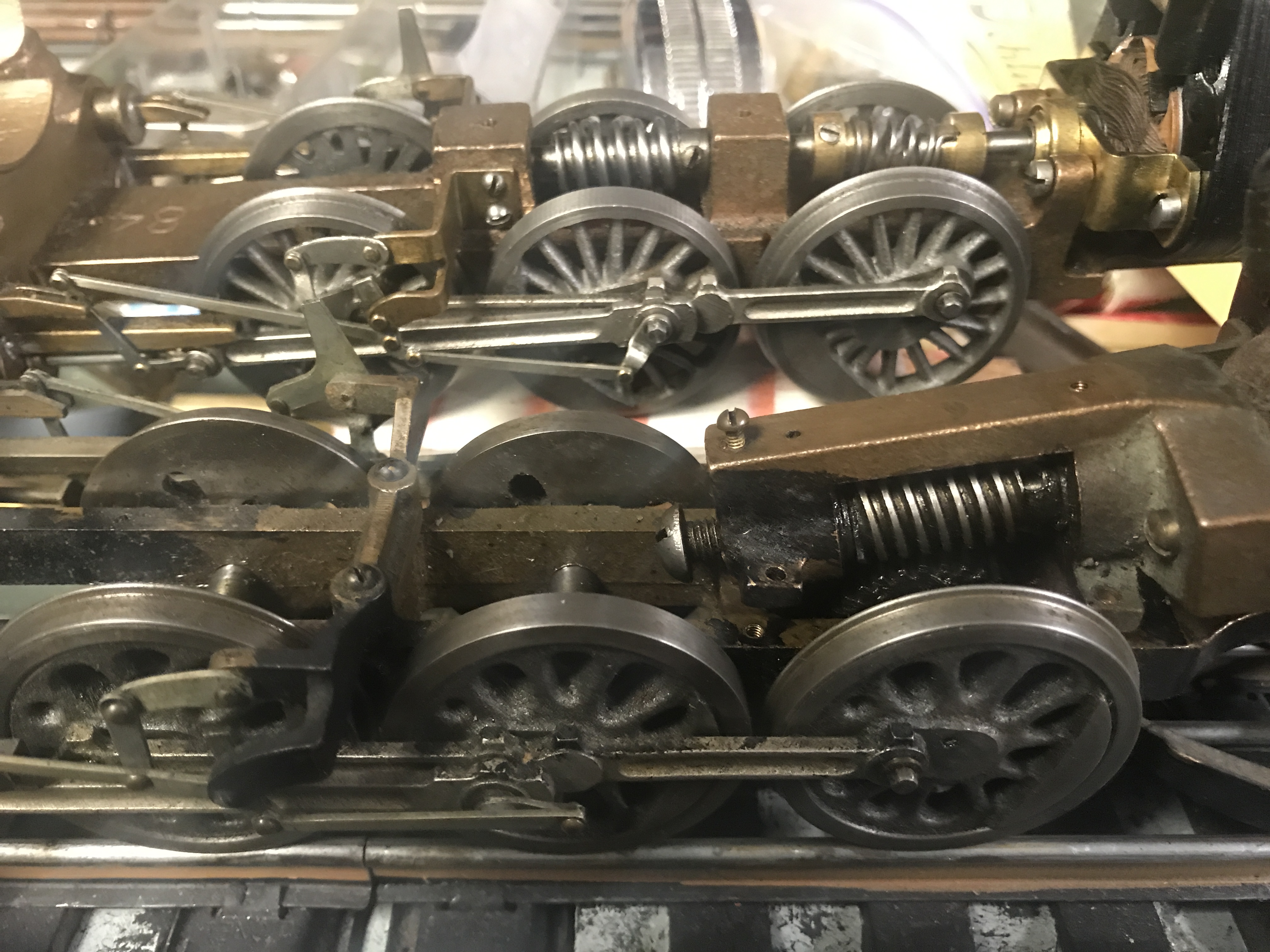

The next was this all black one with rear axle drive. It was two railed and came with a Permag motor. It did run but was rough with some binding. The wheels were machined all over the place, with some being .020" wider than others the gauge was all jacked up. It has straight counterweight drivers, but only 15 spoke and they were machined to 1.603" or so which is a good bit short of a scale 80". The tires and flanges are all out of whack to each other as well. I think can save them but they might just be an experiment. The boiler to firebox joint isn't too bad but not too good either. I'll probably just leave it as is for now... It needs some paint though.
Last is this new one with the Lobaugh drivers. It was complete but had a bit of binding in the valve gear. Work in progress I guess.
I suppose I have visions of grandure, but for now they are all just piles of junk waiting for me.

Elongate the motor mount holes and straighten the drive shaft. Original motor and coupling will give you excellent service - a Pittman/ Toyota hose will make it slightly quieter and snoother. The can motor can be mounted in a tray using old rubber sheets and aircraft safety wire. My trays are just leftover segments of old boiler material.

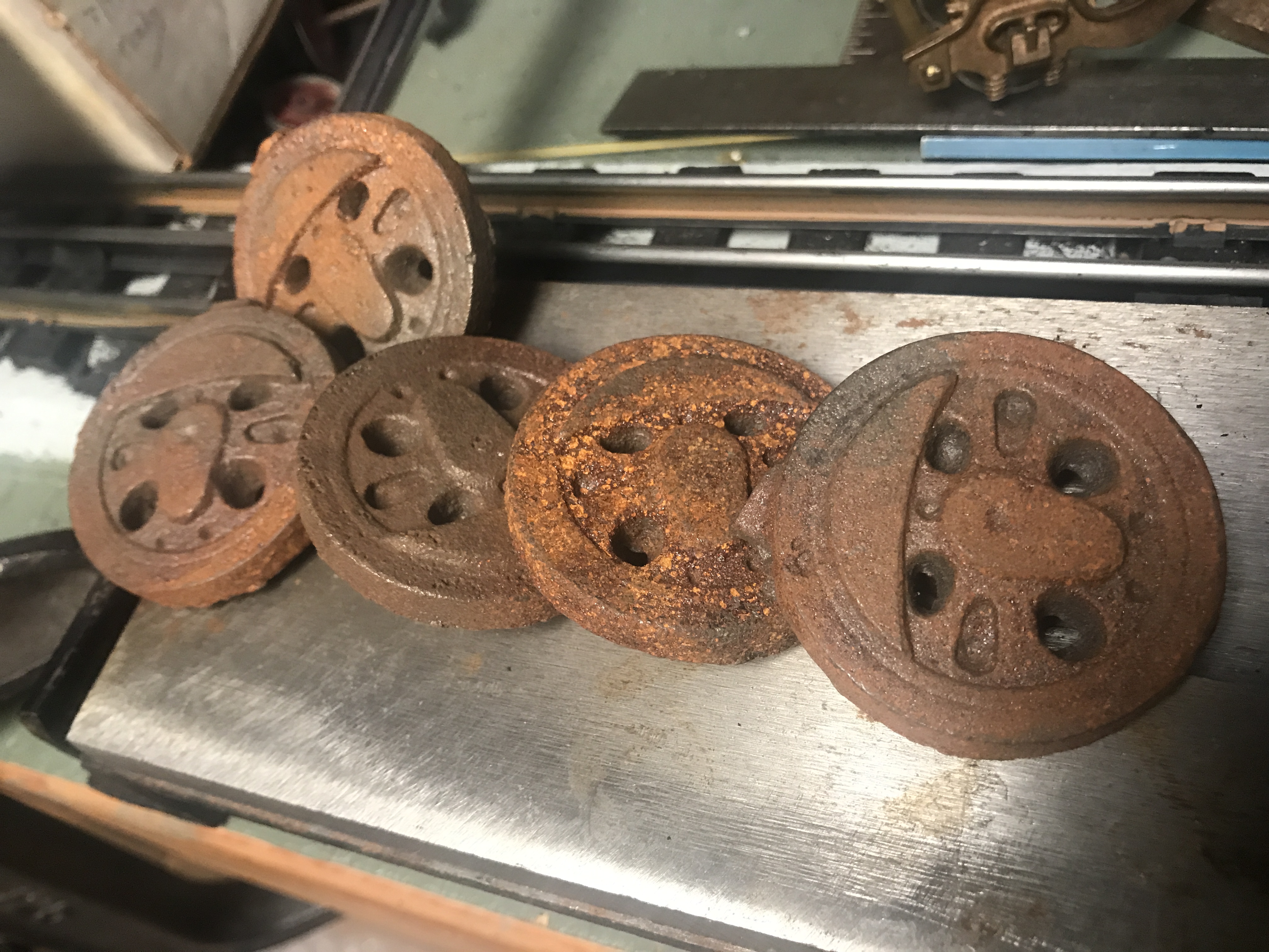

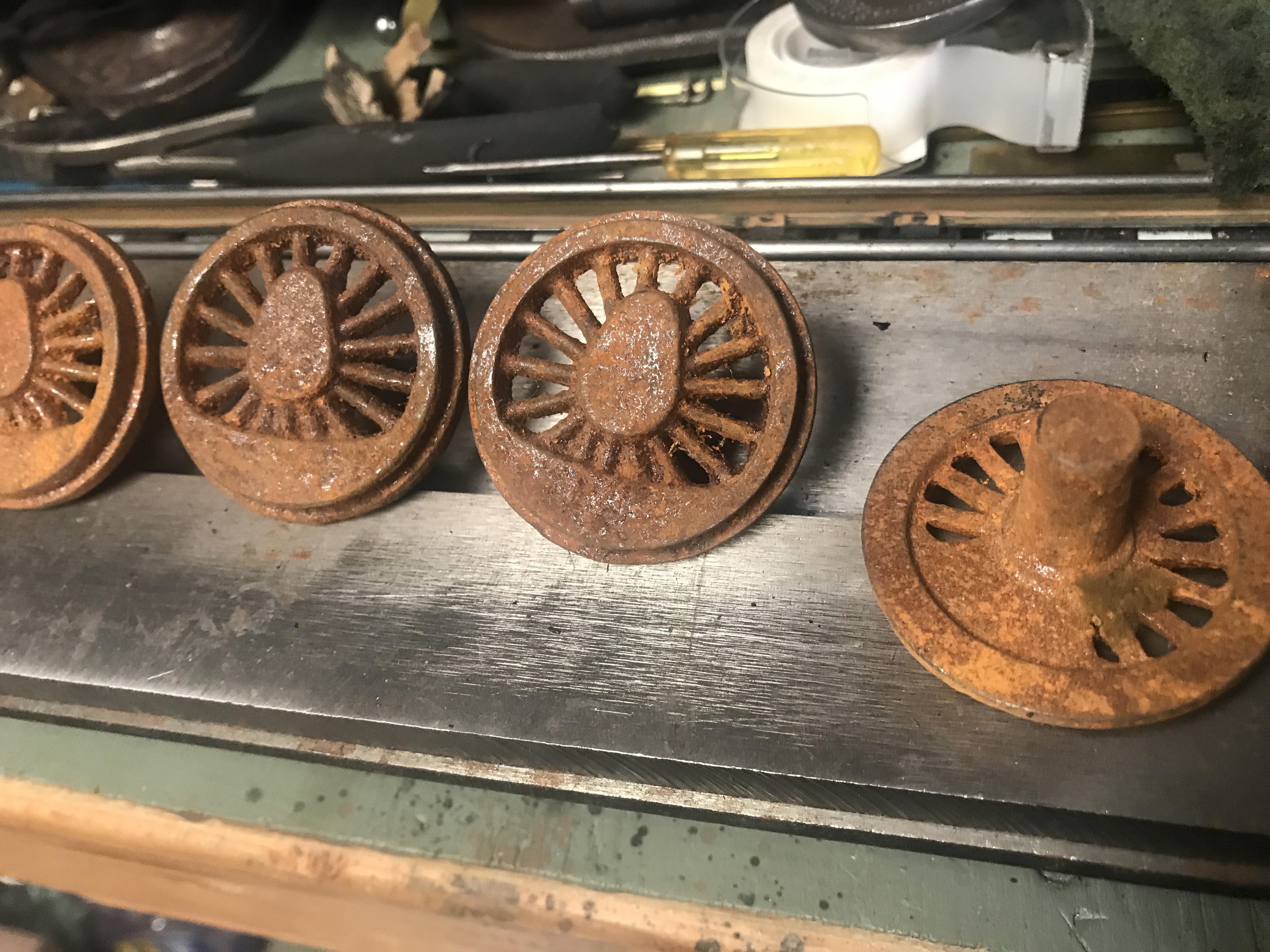

So do you think these are Scalecraft castings?
I know the next (partial) set is not... too bad I only have the five and not six...
Don't know where the second set came from....

You are ready. Machine six tires. Use the Lobaugh for sizes.
Then machine the "button" to fit whatever collet you have. When you turn the driver around, make sure the rim is concentric. It usually is, because most castings are dimensionally pretty good. If they do not cut like hot butter, they need to be annealed.
First cut is the face cut. Just remove the scale and get a smooth surface on CWT and crankpin boss.
Second cut is the rim. It goes deeper than the first cut. How much is a matter of taste, but use Lobaugh as a guide.
Third cut is a very small square groove, separating rim from CWT. Again, use Lobaugh as your guide.
Three of your castings can be machined to match your tires. I recommend that - the cast iron is a lot like traction tires. It "grabs!"
The other three get trimmed to accept paper insulation and tires.
Bore the axle holes with a center drill, then a good solid crankshaft drill (short). Bore the crankpin holes with a jig!
Facing the back is the last step. You can do that in the 3-jaw. It isn't critical, but use care to keep it parallel to the face cuts.
Good luck!
Good luck!
