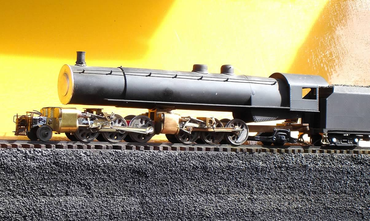

Here is a preliminary photo:

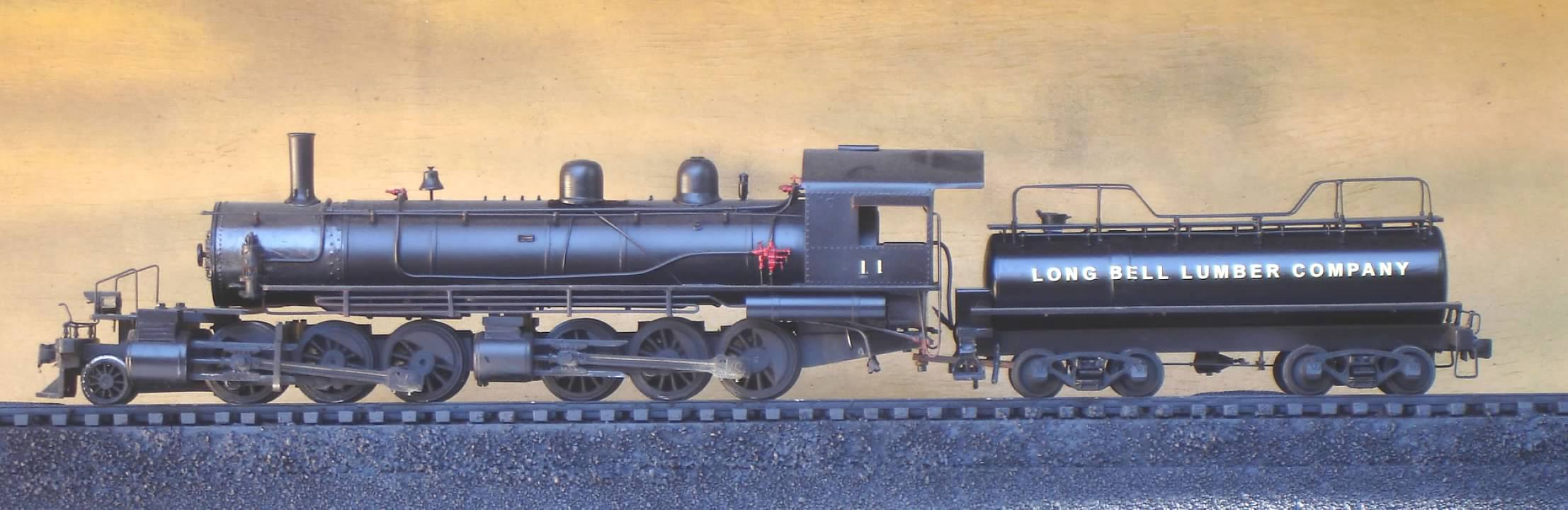

Yes. This is my preferred method of powering an articulated steam model:
The mechanism is under my OSN "Back-up Malley." It runs like a watch, and is one of the few locomotives that sort of stays on my outer test loop. The front gearbox is a Mod O.6, and the rear - you cannot see it - is the smaller Mod O.5. The gear ratios are different, so it goes in and out of synchronization every 24 driver revolutions. You cannot tell it is periodic - you can tell that it does not go around the track always in the same synchronization, like most model articulateds.
But the big deal is you cannot see the driveshaft. To me this is really important in a steam model, along with the idea that I can have round boiler bellies without giant slots.
These are 65" scale drivers, but I have done the same thing using two smaller O.5 gearboxes on my Log Mallet, which uses 54" drivers. This thing is really powered, and does run with a small Escap motor. It has ball bearings on all driver axles, something I will never do again (alignment is critical, for one thing).
It is freelance, but approximates locomotives used by Long-Bell, Weyerhaeuser, and others in the Pacific Northwest. I might someday convert it to tender drive so I can use an 8000-series Pittman, but for now it just rests on the display shelf.

I converted the rear frame to Baldwin Discs, and freed up both mechanisms so they roll without weight on them. Now it is time for the driveshaft.
It has been well over two decades since I did the above MM2 for OSN - older readers might remember a ten part construction series. So I had forgotten the constraints. One was the driver boxes have to be skinny to accommodate the wider NWSL box. Another was that, since the drive shaft is so low, the rear frame has to be dished out to accommodate even a speedometer type flex drive.
I found a new way to make the sliding joint work - I filed the front gearbox shaft square, and soldered a 1/8" square piece of brass on it - then I polished the brass for a slip fit into the next largest square tube (K&S still produces these). The slip joint on this model is out in the open, so when I join the two engines, it is not a "feel in the dark" problem. Also, I no longer have to square up the end of the speedometer cable - just tin it and solder the tube on. Lots easier and quicker.
Track test next week, after I get that Lobaugh Challenger off the #3 loop. Maybe a photo if I get the mechanisms all prettied up -
A note on balance - forward engines for Challengers are notoriously nose heavy. I make my forward engine cylinders as light as I can - the big Mallet got an aluminum cylinder block. This one uses the PS-4 castings, which means the cylinders are almost hollow shells. On the Challenger, I added a huge brass one piece pedestal binder to the rear drivers, and a 1/4" thick steel weight under that that goes forward partway around the gearbox. That, and the lead truck has a potent spring . . .

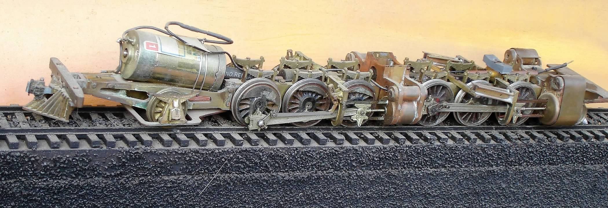

I was getting ready to post a photo of a similar mechanism, but realized I had already done so a couple posts ago. While I hate repeated photos, here it is again, with more comments.
The big points: The motor is angled down quite a bit to match the mostly horizontal drive shaft. That is Toyota vacuum line making the bend. My new mechanism uses the same idea, but a short hunk of speedometer cable is in there to avoid the rear driver bearing, which in this case extends completely across the axle, and is covered by a piece of sheet metal to strengthen an area the previous owner had modified with an errant Dremel grinder.
I will get photos of my connection to the front engine in a couple days - suffice to say that I have become tired of the connection being under the rear cylinder block, where I cannot see it when sliding it in place. Oh - and to dazzle you with the nice end mill slot under said cylinder block to clear the speedometer cable. As always, note that the gearbox shafts are all behind the drivers, so you get the illusion of a real steam locomotive - one without shafts and gearboxes showing in the side view!
Finally, note those gorgeous dummy driver springs. Bob Stevenson has the master, and it is cored for an easy #52 drill bit, so you can hold them to the frame with an 0-80 screw. Alas, my source of steel hex head 0-80s has become either unaffordable or extinct. I have to use cap screws or studs with nuts now.

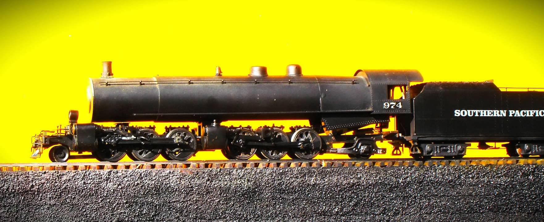

"Soon"= a month and a half.
This thing has survived about thirty trips around the test track dragging three Lobaugh "Mobilgas" tanks and a caboose, without any major hiccups. It is about to get retired - I may put some pipes on, just so I can paint the fittings red. Oh, and cab window mullions for exactly the same reason.
It is "dirtbag" because it is made of an old exhaust pipe and a cab I had laying around many years ago - used strictly for testing articulated engine mechanisms, and never intended as an actual model. I put it in the 900 class, partly because very early SP Mallets had that series, but mostly because it was so easy to snip out of the decal sheet. If it ever becomes an actual model with injectors and check valves it will become MM-3 # 3932.
I can see I forgot to tighten the rear mounting screw - looks like it is sniffing for peanuts. Easy fix.
