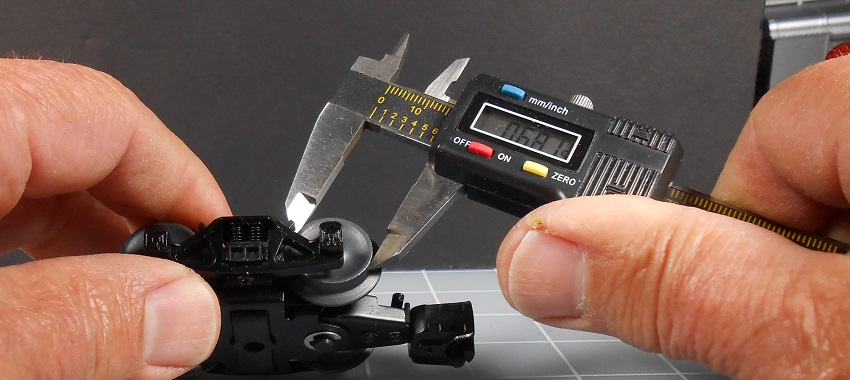

Roy wrote:I'm sure Wayne can calculate the ideal track curvature that corresponds to the conic angle of the treads, where they get the ideal differential action.
Of course, anyone can do that, it is basic algebra. Average performers get introduced to algebra in the eighth grade.
Those
on my 6-17767 are not flat.Roy wrote:… flat treaded wheels…
They have a diameter of 0.681 inches on the outer part
and 0.691 inches on the inside (near flange.)
Algebraic answer: O-127 curves.

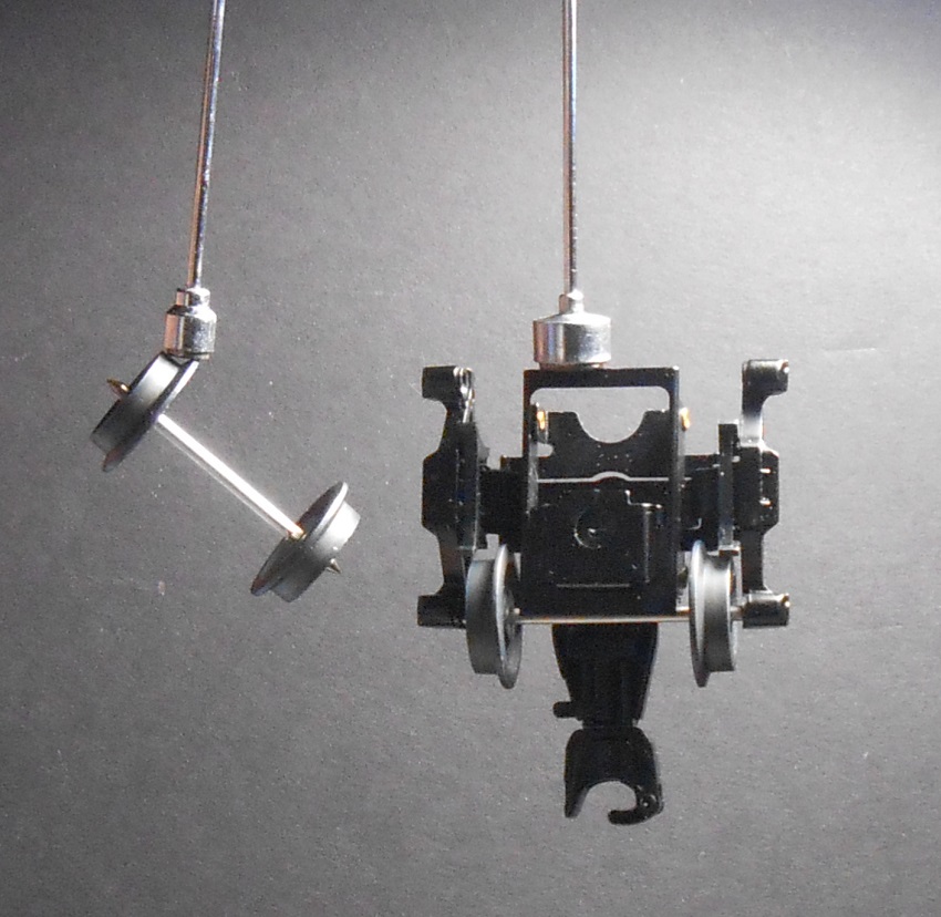

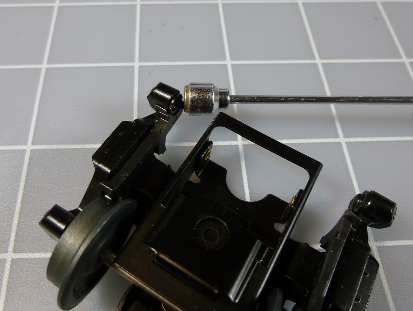

No more guessing, I tested the materials with a magnet.
The wheels, axle, bolster and coupler frame are Ferromagnetic. See "magnet test 1."
The polyoxymethylene (Delrin) conical pocket bearings, zinc side frames and coupler are Diamagnetic. See "magnet test 2."
Magnet test 2 only revealed the materials were not ferromagnetic. Had to look them up to see if they were paramagnetic or diamagnetic (or maybe weakly ferromagnetic.)
Edit 1: Changed "polyoxymthylene (Derlin)" to "polyoxmethylene (Delrin)".
Edit 2: Actually did what I said in "Edit 1" this time!
