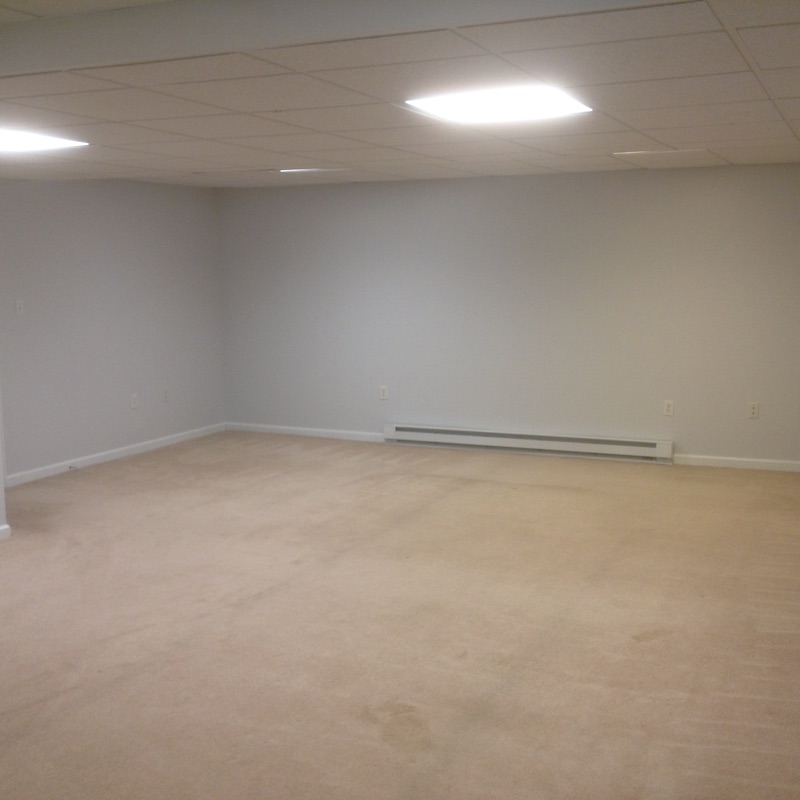

We moved into the new house on Friday, May 5. Before the movers began hauling boxes, here's what the new train room looked like:

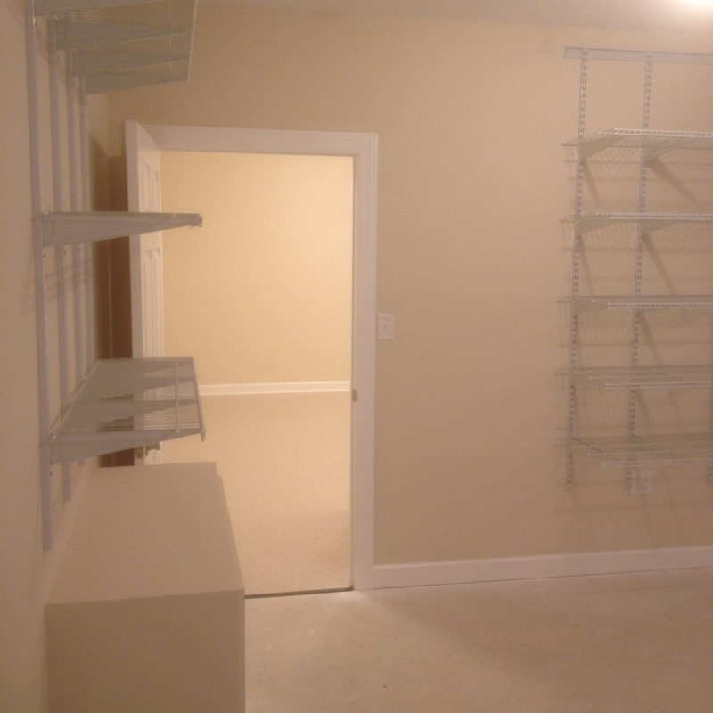

And the workshop:
And the workshop:

Re: What's New on the PRR Panhandle 2.0?
Tabula Rassa, good luck. Last photo, what is that in the room off the main room? It looks like a water fountain?
chuck wrote:Tabula Rassa, good luck. Last photo, what is that in the room off the main room? It looks like a water fountain?
Thank you!
That's a laundry tub. It's inside the furnace room.
George
