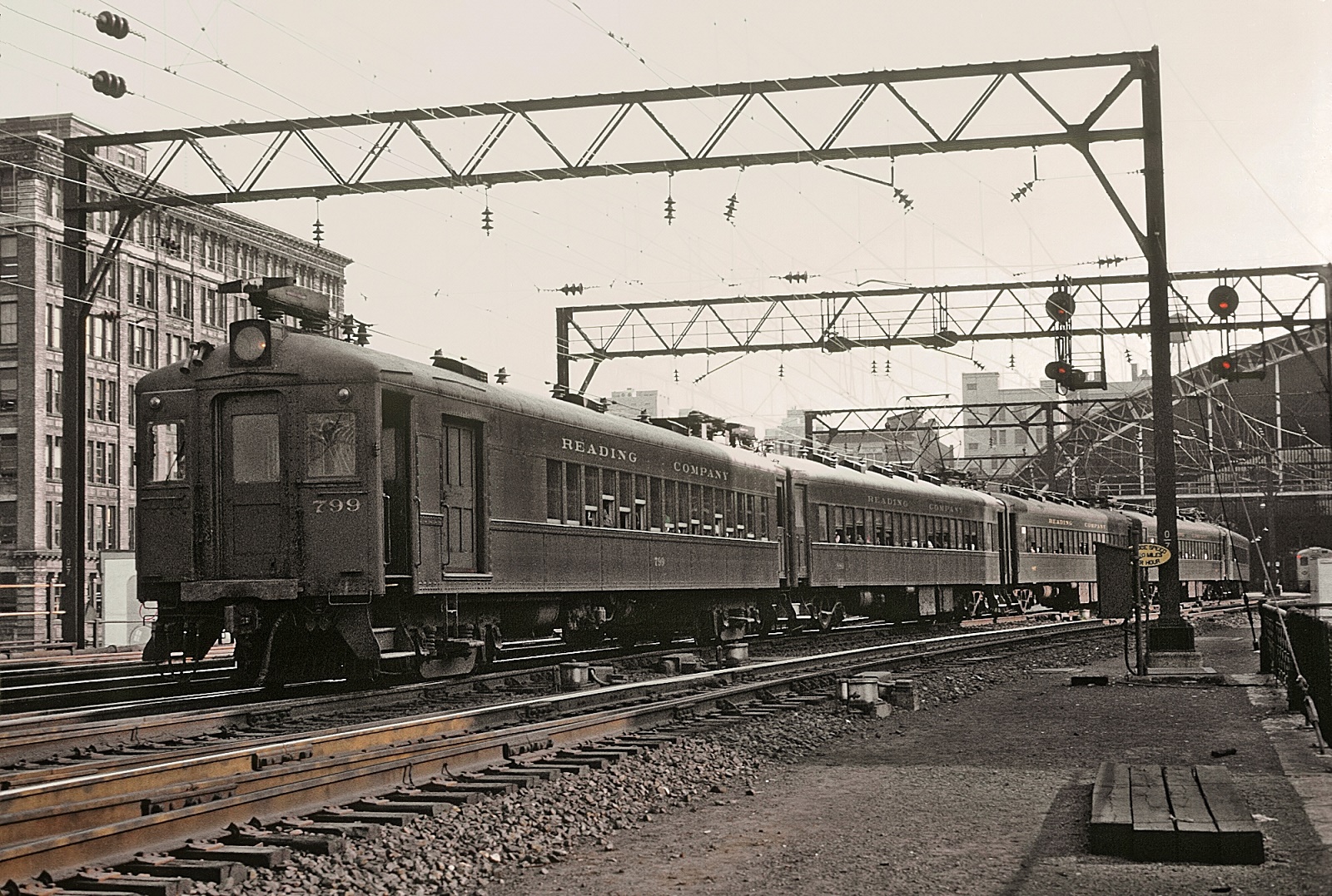

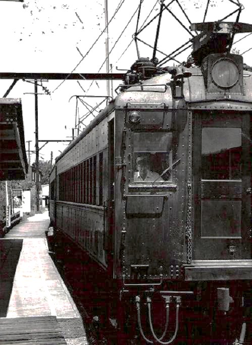

Those orange boxes and protruding (spring loaded by the way) T shaped arms are hi voltage BUSS CONTACTOR BAR to pass the Hi Voltage operating current between one or more coupled Locomotives at roof height -- rather than via using the traditional thick heavy BUSS Jumper Cables down at coupler level. Theese roof mounted buss jumper bars are longer and larger than would be usual on MU passenger cars (*) that used them, mainly because they also have to extend above and protrude over to the outer ends of the "porches" beyond the cab-roof-line-end of the locomotives
(*) The Philly-Reading PA area Reading Railroad's older electric MU cars had the same car to car rooftop buss jumper contact system system -- here are some photos from my collection
Fox Chase Sta-Reading RR-1967.jpg (146.3 KiB) Viewed 26003 times
Reading_RR_Hatboro STA NB- MUs.jpg (102.34 KiB) Viewed 26003 times
Reading 799 near Reading Terminal, Philadelphia, September 1964.jpg (873.49 KiB) Viewed 26003 times
